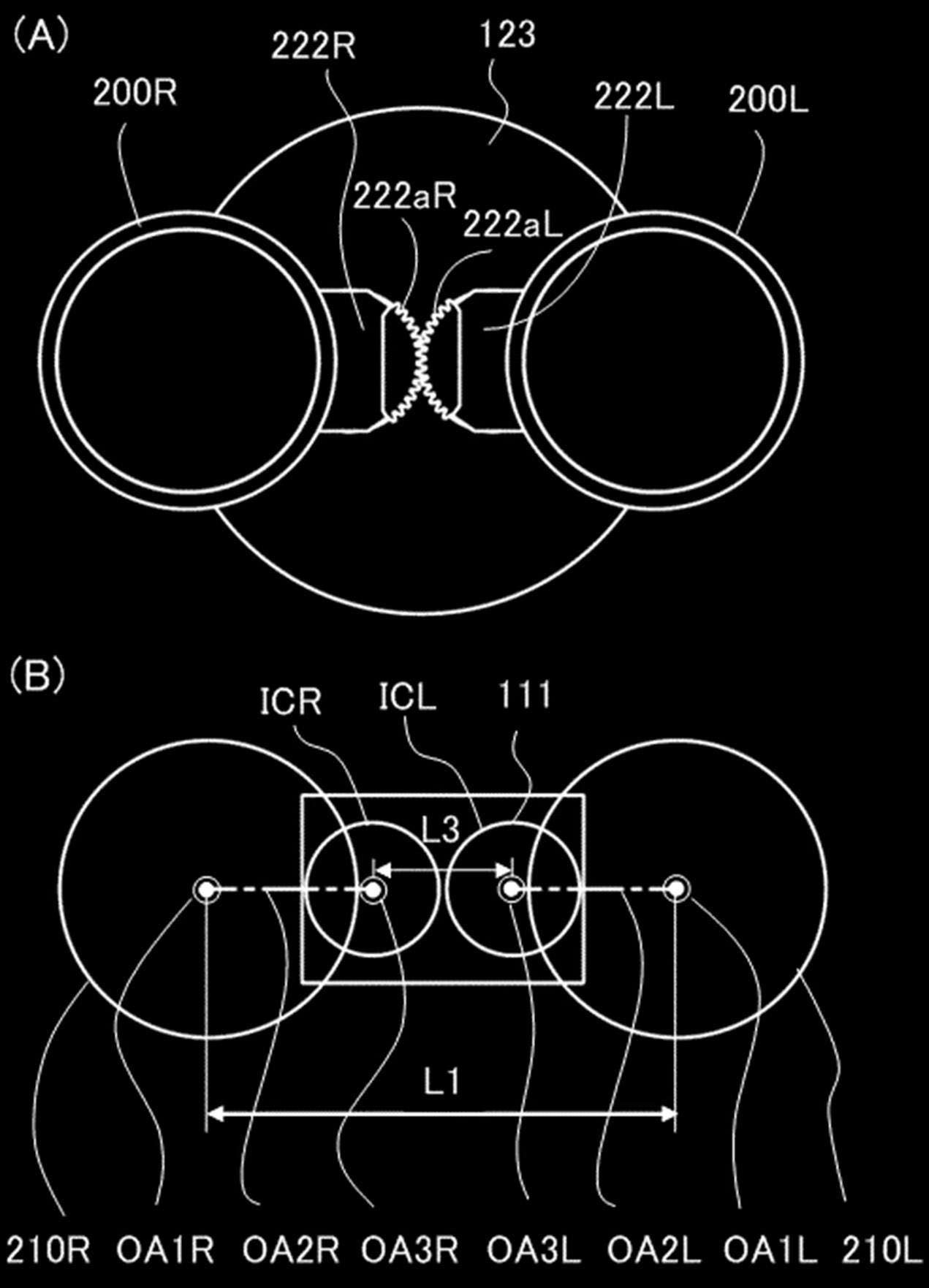

In this patent Canon is describing the Canon RF dual fisheye lens, but with a twist. They want to be able to control the 3D effect and also change the distance the two lenses are apart when the aperture changes.

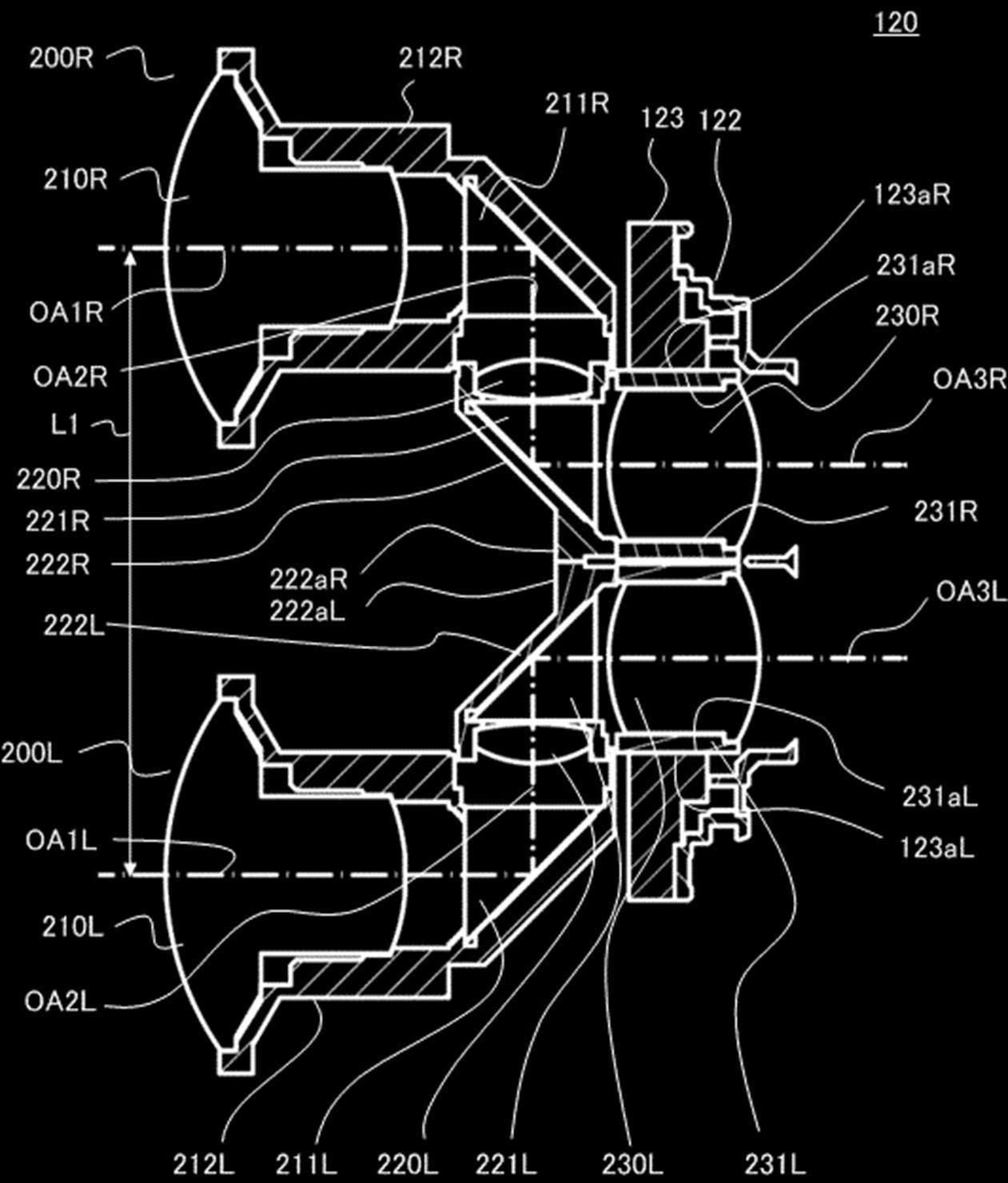

However, you can't just slide the lenses closer or further apart though, as it would change the length of the optical path internally in the lens. So to accomplish this and still be able to vary the distance between the two lenses, Canon has implemented a rotating geared assembly that would rotate both lenses thus changing the distance between the two fisheye lenses, but internally the light path would remain the same length.

  1. This wouldn't merely allow lenses to be closer. Instead, consider if the "default" position was only rotated 1/3 of the way through the quarter-circle. It would thus let you then go like 3x WIDER than that default position, which is often used on binoculars to give an exaggerated effect of 3D.
    So, if the current lens is at all popular, the next version might be a relatively telephoto creation that can be positioned to normal eye separation when only partly deployed, but also a wider, binocular-style separation at full deployment.
  2. This wouldn't merely allow lenses to be closer. Instead, consider if the "default" position was only rotated 1/3 of the way through the quarter-circle. It would thus let you then go like 3x WIDER than that default position, which is often used on binoculars to give an exaggerated effect of 3D.
    I understand about the distance between the lenses changing the 3d effect, but what do you mean, "relatively telephoto"?
  3. but what do you mean, "relatively telephoto"?
    Thanks for hearing me out Eric. I meant more telephoto than the current fisheye :D And given that it uses at most half the sensor, even 40mm would be possibly equivalent to a full-frame 100mm???Also, if the result was still used in VR, then the user might only be looking at 25% of the actual captured view at a time?? So what I was thinking was somewhere between 10mm and say 75mm or something, not actually telephoto as it normally means, such as 135mm+.
