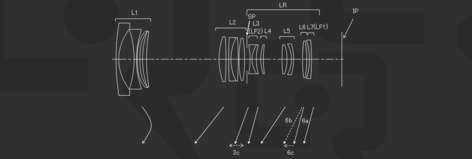

This is an intriguing patent application (2024-074321) because there are a few different embodiments that deserve a closer look than I originally thought reading through it.
First, the 20-60mm F2.8 would cover a lot of focal length bases for me. I love to shoot a bit wider than 24mm, and 60mm seems a nice compromise between 50 and 70mm. This is a fairly complex lens, but not enough that I would necessarily expect a red ring around it.
The 28-70 and 24-70’s embodiments are far simpler in terms of optical design than the current L’s so we could see these are cheaper non-L’s of constant aperture F2.8’s. This wouldn’t be a bad thing at all, giving people more lens options is always a good thing in my world.
All in all, I think these lenses seem to be sitting in between the consumer STM and the professional series L lenses – something that Canon hasn’t regularly explored but we’d be better off if they did.
Canon RF 20-60mm F2.8
NearMiddleFar
Focal Length21.63 41.64   61.25
F-Number2.89     2.89     2.89
Half Angle Of View39.77    27.46    19.45
Lens Length (including focal Plane Distance)171.39   150.09   154.91
Back Focus Distance22.99    26.93    30.88
Canon RF 24-70mm F2.8
NearMiddleFar
Focal Length24.70    46.61    68.70
Half Angle Of View36.73    24.90    17.48
Lens Length (including focal Plane Distance)171.15   152.40   157.34
Back Focus Distance (mm)22.75    25.47    28.19
Canon RF 28-70mm F2.8
NearMiddleFar
Focal Length28.70    49.06    68.70
Half Angle Of View32.71    23.80    17.48
Lens Length (including focal Plane Distance)158.44   146.78   153.21
Back Focus Distance22.44    23.91    26.15
