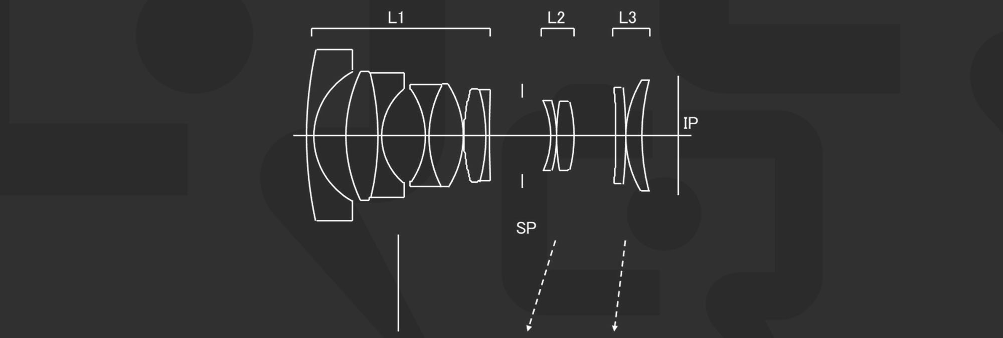

In this patent application (2024-061921), Canon is showing off some curious embodiments for some prime lenses.
These are full-image circle primes with no image stretching so understandably they would be targetted as higher-end primes. Maybe Canon got tired of my whining on the subject and decided to shut me up.
But what I found most curious is that the focal lengths are a bit odd being at 34mm (close enough to 35mm?) and also even more interesting is the embodiment of a 26mm lens. The 26mm of course sits right between Canon’s usual focal lengths of 24 and 28mm.
I’m also going to make a guess that these lenses also have a very small minimum focus distance as “close up” is mentioned frequently. But usually, it is stated in the embodiments as a magnification factor if Canon is applying for a macro lens patent. Canon also mentions that size is an important objective but these lenses are 4 inches long, which leads me to think that there’s more than just a normal prime illustrated in these examples.
Canon in their patent application writeup simply states;
 In recent years, imaging devices using solid-state imaging devices, such as digital still cameras, video cameras, surveillance cameras, broadcasting cameras, and silver halide photography cameras, have become more sophisticated. As an optical system used therefor, there is a demand for miniaturization of the entire focus group. Furthermore, there is a need for an optical system that can increase the imaging magnification when focusing from infinity to close range, while also being able to satisfactorily correct chromatic aberration, field curvature, etc. when shooting at the closest range. Additionally, with the shift to mirrorless large-format cameras, there is a demand for lenses with short back focus, small size, and large aperture.

Focal length            26.62
F number 1.44
Half angle of view (°) 39.10
Image height 21.64
Lens total length 131.96
BF 20.00
Canon RF 35mm F1.4
Focal length            33.87
F number 1.44
Half angle of view (°) 32.57
Image height 21.64
Lens total length 131.26
BF 16.49
As with all patent applications, this is a look into Canon’s research, and may never end up in an actual product.
Japan Patent Application 2024-061921
