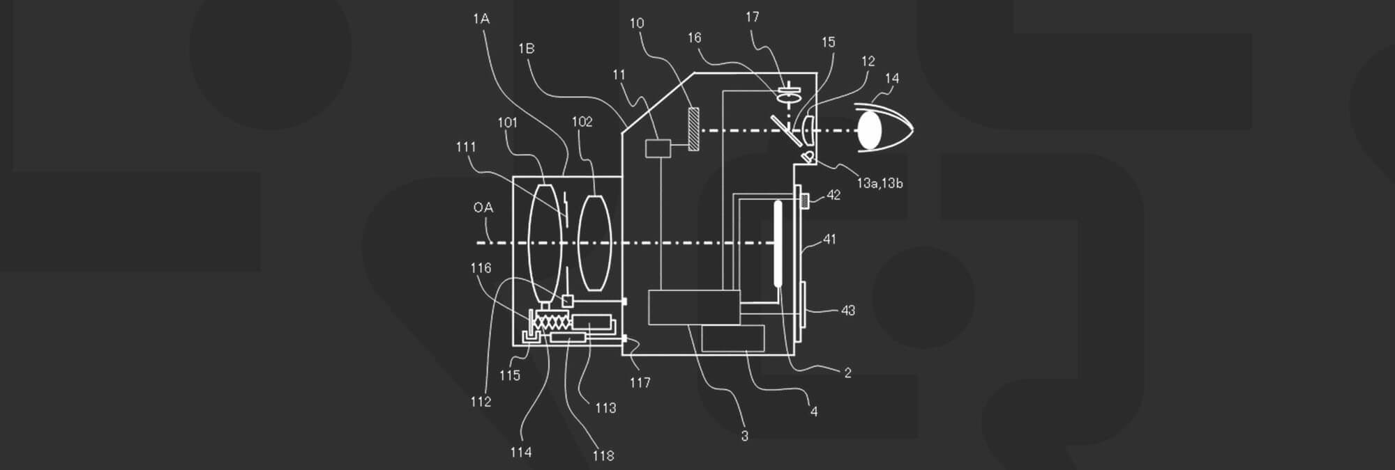

In this patent application (2024-053967) Canon is looking to improve the ability of the cameras to calibrate the eye control focus with the photographer. The eye control focus is featured on older EOS film cameras and more notably, the Canon EOS R3. Eye Control AF differs from Eye AF, as Eye Control AF moves the focus point to where you are looking through the viewfinder, and Eye AF locks onto the target's eye as the focus point.
The camera does eye control by shining infrared light into your eye and measuring the relative location of your pupil. Using that, the camera can calculate where you are looking. Because of this, and because it's a very individual measurement, each person has to be calibrated to use eye control autofocus. Canon in this patent is looking at increasing the precision without necessarily increasing the time it takes to calibrate eye control.
According to Canon's machine-translated patent-speak;
An object of the present invention is to provide a line of sight detection device that can perform highly accurate correction while reducing the burden on the user.
According to the patent application, it appears as if the detection is sensitive to the diameter of the user's pupil. This surprised me, but it does stand to reason because Canon does specify that you need to take calibration indoors and outdoors – which would cause users to have a different pupil size with the variation in light intensity. It should probably be noted that it may even be a good thing to expand on the calibration to include overcast conditions, etc.

  1. The R3's Eye Control does not work for me. I still love the camera, but wish this feature worked. Don't purchase the camera IF that feature is your main reason for doing so. I wear glasses and that has got to affect the performance of the IR beam. I also had RK surgery (radial keratotomy) on my eyes years ago, so even if I remove my glasses it's unable to calibrate. I suspect the scars on my cornea from the operation are causing the light to scatter or reflect enough that it can't lock on. ??? It could be a very helpful feature if they can get it to work better and over a wider range of users.
