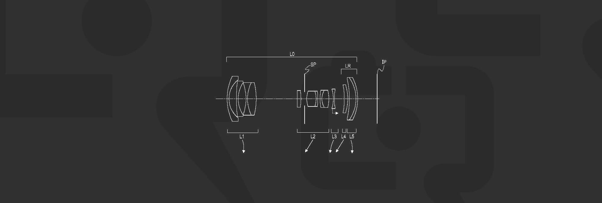

In this patent application (2024-007656), Canon looks to create small ultra wides for both full frame and crop. One of the designs is curiously either similar or is the RF-S 10-18mm f/4.5-6.3. If it is the actual RF-S 10-18, then it also gives us the lowest back focus distance for the RF mount that Canon feels comfortable with. Of course, this can be easily seen by looking at images of the 10-18, and while it does sit pretty far back into the mount, it doesn’t seem to sit back 10mm (going by images, the lens seems to sit back around 6mm, or a back focus distance of around 14mm). The embodiment is detailed here.
                   Wide angle Intermediate Telephoto
focal length          10.30       14.00      17.50
F number               4.63        5.41       6.13
Half angle of view    53.00       44.30      38.00
Image height          11.28       12.50      12.95
Lens total length     74.63       72.93      73.78
BF                    10.97       10.97      10.97
There is one full-frame lens described in the embodiments, but while it’s 15-30mm, its elements do not match up to the commercialized Canon Lens RF 15-30mm f/4.5-6.3 IS STM.
One intriguing RF-S lens that some may be interested in (including me!) and it’s the 10-20mm F4.0 which is also an inner zoom design of a constant 75mm (or 55mm for the lens itself). On the camera, the lens would sit around 46mm out from the mount making it a very small compact lens. I don’t think Canon considers the RF-S mount a serious enough platform to create specific fast more professional zoom lenses for. However, I have been wrong before, so if there’s a lens in there worth mentioning, I’m going to assume it’s this one.
Canon RF-S 10-20mm F4.0
focal length          10.30       15.00      19.40
F number               4.12        4.12       4.12
Half angle of view    52.90       42.30      35.20
Image height          11.38       12.95      13.52
lens total length     75.89       75.89      75.89
Japan Patent Application: 2024-007656
