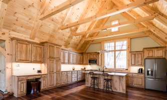

Durf said:
Here's a shot I took at 16mm, 1/8 of a second at f/8 ISO 100.
You can see a little distortion, especially on the left side of the image....
That is not a lens aberration (lens distortion), it is a projection issue that was created because the camera was not level. Any decent processing software, DPP, Lightroom, Photoshop, etc etc all have lens distortion correction profiles built in that easily correct for the actual lens distortions at all individual focal lengths, they also correct for vignetting if you want them to.
Keep the camera level and the 16-35 has a bit of barrel distortion below 20mm but after 24 is a very solid lens.
https://www.lenstip.com/411.6-Lens_review-Canon_EF_16-35_mm_f_4L_IS_USM_Distortion.html
https://www.the-digital-picture.com/Reviews/Lens-Distortion.aspx?Lens=949&Camera=453&FLIComp=0&LensComp=0&CameraComp=0&FLI=4
privatebydesign
I post too Much on Here!!
Jan 29, 2011
10,693
6,121
Durf said:
Camera was actually leveled on a tripod, every shot I took that day was on a tripod and leveled....

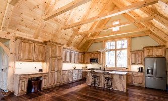

You have a problem with your leveling equipment then because the camera was not level, if it was the vertical lines would be vertical but have a slight bow outwards from 16-20 mm.
Picture one, the red lines illustrate the fact that your camera could not be level, if it was the two lines would be parallel they would not converge.
Picture two shows what the image would look like if the camera was level.
Picture three is with the camera leveled and the appropriate lens correction profile applied.

Durf said:
Thanks, I think I was using a cheap hot shoe bubble level that day, can't remember though. I do remember trying to get all the shots leveled the best I could, must of screwed up on this shot for sure.
You fixed it well! ;)
Yes I moved from a bubble level to learn to trust the electronic level in the camera, it isn't always precise but it is better than the bubble ever was :) I use a geared head too because it is the only way I have found to get the results I demand.
I didn't really fix it, I just pushed the buttons in PS!
All the best.

privatebydesign said:
All the best.
Thanks
I'm always using the in camera level now too....(lost my cheap bubble level!) LOL
