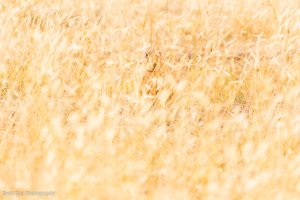

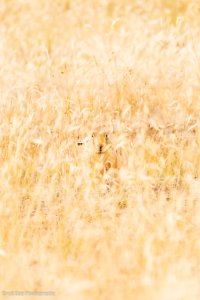

This is another situation where the R6 AF system just could not cope( I doubt ANY AF system would work here). I had to resort to manual focus to get these shots as there was just too much grass waving around in front of the HareView attachment 195569View attachment 195570View attachment 195571
It would take a higher form of artificial intelligence to sort those out. Did using just the centre point fail? I have just posted a couple of shots in the Bird Portrait thread illustrating how the eyeAF can find the head of tiny distant birds.
