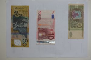

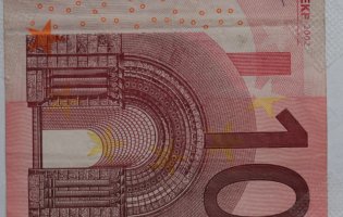

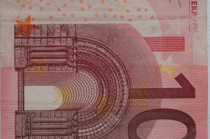

Tested today:
Mk II vs Mk III sharpness: Carl Zeiss ZE 100 and 50 MP @ f 4, Av, 1/45-50, LV focusing + shot, 2sec delay release, ISO 100, RAW, Neutral PS, no sharpening during RAW import into Aperture, same export setting for JPEG.
Can't find any difference. Initially I shot only once and imported both files onto my MBP. Looked at them and noticed a slight advantage to the 5D2. Then, I decided to do five additional shots for each with refocusing and average the findings - imported them into my MacPro and looked on the big screen - no difference. The initial impression was mis focusing.
The MarkIII went 1/45 at f/4 and the MarkII went 1/50 but came brighter, don't know why.
Both exposures changed 2/3 stops between LV metering and standard metering. Don't know why. This was a surprise to me, I went to Manual at 1/60 for both and f/4 and between VF and LV metering there was 2/3 stop EV difference.
The 500 ruble note is low value paper - disintegrated while untaping. The Aussie behaved best.
My Manual shots are unfortunately at home now. Results are unequivocal for me: the debate "softer or not softer" should end here. Both Marks are nearly if not the same to me.
