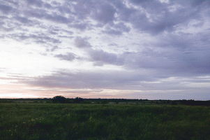

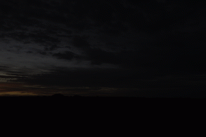

I read this thread and almost got a case of dystopia myself. Maybe I am missing the point but I took this picture the other morning at dawn and maybe I'm doing it wrong but I don't see anything. The first pic is obviously underexposed by a lot (1/60, ISO 100, f5.0 , 35mm), taken with the 5Dmk4, 16-35 MK3. The second pic was processed with LR and pushed 5 stops, highlights 100%, shadows 100%, no banding.
P.S. If this is a real issue maybe my camera is not affected.

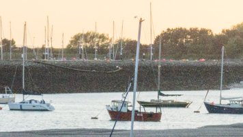

I'd say there is nothing wrong with any of these cameras. For the record here's what happens when you lift the exmor sensor by 5 stops and then do a 50% lift on the shadows slider. It's not pretty. Do you think that bank really had magenta and green bands running through it ?
