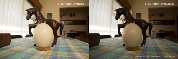

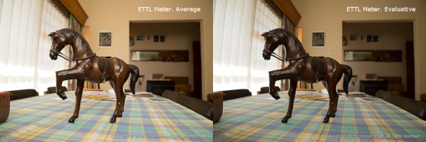

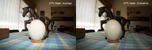

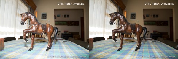

I did a series of tests a while back bounce flash and direct flash using evaluative and average TTL metering. I used a specular dark subject as well as a matte mid-tone subject. Note there are harsh highlights in the "background".
These were the results:

Jack Douglas said:
Interesting and useful, how do you interpret or generalize on your results?
Jack
Sorry, I completely forgot about this thread...
Disclaimer: I do not claim 100% accuracy as this info is not clearly laid out in the Canon literature I've found so far. This is how I believe the ETTL flash metering works in the Canon system.
It would have been nice if Canon used a different terms for camera evaluative metering (full scene ambient measurements) and ETTL evaluative flash metering. (flash contribution measurements) This cause me quite a bit of confusion for many months when I started shooting with flash.
When you are using ETTL flash, the camera automatically also meters the ambient across the entire frame regardless of what camera metering mode you are using. When you subsequently push the shutter release, the camera sends a pre-flash and measures a flash contribution exposure. It then compares the ambient exposure with the pre-flash exposure and calculates the required power to "properly" exposure and add/subtracts whatever flash-exposure-compensation(FEC) you've dialed in before firing the shot.
There are two ETTL metering modes Evaluative and Average. ETTL Evaluative metering takes focus distance info as well as subject reflectivity into consideration when determining a "proper" exposure. Average only considers how much light is being bounced back from the pre-flash and ignores harsh reflections. I would avoid ETTL average metering for direct flash, especially if there is a close foreground subject. IMO average is best used for bounce flash.
If you have highly reflective objects in the frame then evaluative will underexpose to try to protect against hotspots. If you do not care to preserve the specular highlights then average will work fine. If you do want to preserve the highlights then evaluative gives you some highlight protection. If using direct flash (e.g. fill-flash) then evaluative is useful as it takes depth info from the autofocus system to dial in the correct power.
I prefer to use bounce flash. I use ETTL evaluative most of the time and dial in FEC as required. I don't have the presence of mind to shoot manual flash outside of a studio setting.

Put more simply, Evaluative tries to determine the subject within the scene and attempts to expose that to 12% grey regardless of the surrounding scene. It does this by comparing the reflectivity within the various metering zones and takes subject distance into account when using a lens that reports it.
Average doesn't do the zone thing and doesn't try to work out what your subject is, it just trys to put out enough light to get the entire frame to 12% grey.
Both have their strengths and weaknesses, the nice thing about Evaluative is the subject prioritization, any FEC only needs to account for the subject reflectance, but it is proprietary and we don't know how much power the flash will contribute for any single exposure as it changes as the EV changes. The nice thing about Average is it is more predictable but more difficult to work out required FEC on the run, is the subject dark, how far is the background, does the flash have the power to light the entire scene etc all need to be answered to work Average with any consistency.
So a scenario, you are at the Superbowl on the sideline, you need some fill flash for the end of game rush onto the field and congratulations, you have the perfect angle kneeling and looking up with the stands in the background and the winning coach and quarterback shaking hands just a few feet in front of you, in AV and Evaluative the flash will expose the two subjects well and the shutter speed will drag to get the stands not black, in Average it will over expose the subjects and the stands will be dark because it is trying to light the stands and the subjects so will default to full power.
