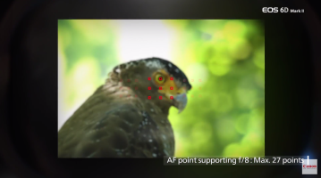

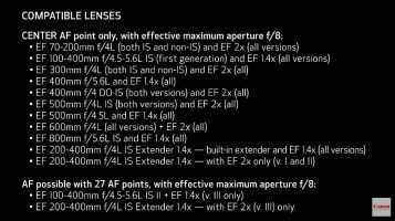

See two pics attached.
The first is from the official Canon 6D2 overview video here. Right at the 2 minute mark, they state 27 f/8 AF points for the teleconverter crowd.
The second is the f/8 shooting info video from Canon, shown here. Only two lenses -- and for a 6D2 owner, let's be frank, really only one that they might own -- get the 27 f/8 AF point functionality mentioned in the first video.
All the rest of those teleconvertered combinations only get the center AF point at f/8.
Wow. I did not know that -- did you?

Haven't people been complaining about the fact that 6DII got the 80D's AF system? This is from well over a year ago...
[quote author=Canon DLC in Feb 2016]
Focus with 27 AF points, at f/8, with newest tele lenses + extenders
For technical reasons, two of the latest super tele zoom lenses from Canon can provide added AF coverage, if they’re combined with the most recent Version III Canon EF tele extenders. Twenty-seven AF points are available, as shown here:
For technical reasons, Canon’s most recent Version III EF 1.4x and 2x tele extenders can combine with the latest super-telephoto lenses to provide even broader coverage at the EOS 80D’s AF sensor. These two lens + extender combinations allow AF at these 27 AF points. And, users can freely manually select any one of these AF points, as well as change to different AF Area options.
Lenses providing this broader 27-point coverage at f/8 effective maximum apertures with the EOS 80D are:
EF 100–400mm f/4.5–5.6L IS II + Extender EF 1.4x III
EF 200–400mm f/4L IS Extender 1.4x lens + Extender EF 2x III (built-in extender not used)

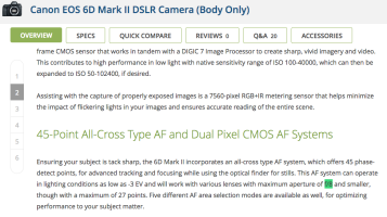

So doesn't that no-fine-print-or-footnote-listed comment in the release video above, release info at B&H (below) kind of set up some birders for a nasty trap here? The camera can be returned, of course, but if you bird, you really need to (at least) RTFM before committing dollars, right?
