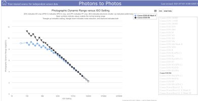

What iso are you happy with in the 6D II? The R6 doesn’t have any effective DR/noise advantage over about 1600iso.
Probably the biggest difference you could make to your high iso images is trialing several of the latest RAW converters and noise reduction software plugins and getting the benefits of them. They will be more impactful than the difference between those two bodies and the lenses really won’t help much because of the focus accuracy and very narrow depth of field.

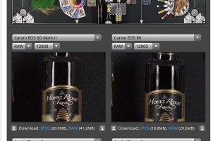

What iso are you happy with in the 6D II? The R6 doesn’t have any effective DR/noise advantage over about 1600iso. View attachment 200826
Note that the JPEG from the 6D2 is much bigger than the R6 one. Shooting Raw, you would have a lot more to work with in the larger file as far as noise abatement. Even in this apples-oranges comparison, much of the noise from the 6D2 appears to be color noise, which Photoshop deals with very easily with little if any loss of detail. In real life, I have had little cause to use ISO 12800. ISO 6400 is my usual upper limit, and generally gives me usable if not optimal results. Large expanses of nearly black will show a lot of noise, as in this example. If you get rid of all of it, it looks like an over correction. I have been known to use Photoshop’s “Add Noise” to add finer grain back and make it look more natural.
I used the ‘print’ feature on DPReview to normalize the RAW images so they are an accurate and legitimate comparison.
Of course as Sporgon points out the differences in the two cameras shouldn’t be left to a single metric, the R6 is a vastly better camera than the 6D II in pretty much every metric. But it is an EVF instead of an OVF and native RF mount so a ‘simple’ body upgrade will quickly devolve into a lot more than that!

OK, so a pretty good comparison, rather than cropped out-of-camera JPEGs as I assumed. Thanks for the clarification.
