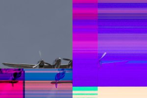

Wow, been a while since I check in here, thanks for suggestions. I havne't made much progress but potentially gathered some more info:
-I'm now getting quite a few corrupt files on the Lexar CF card I mentioned earlier which was purchased at the same time (I stopped using the SD card long ago)
-The SD care was purchased at a reputable supplier and was also replaced once after the issue first showed up
-Corruption doesn't seem to happen on any other cards
-Happens when downloading via USB3 card reader or directly from the camera (also USB3)
-Occurs on the raw image (I typically don't shoot jpeg so don't know about them)
-I have tried using the RAW converter in camera but the resulting jpeg is still corrupt
I'm currently on an around the world trip so can't try my USB2 card reader, downloading from my mark I or provide a return address for a replacement just yet. Here's an example of one I got of a the CF card just recently.
I'm currently on an around the world trip so can't try my USB2 card reader or downloading from my mark I. Here's an example of one I got of a the CF card just recently.
Did you send the card back to Lexar? They are guaranteed forever. I'd do that and see what happens. It could be a incompatibility with the USB 3 controller in the camera, but since at least 100,000 7D MK II's are out there and I've only seen 2 or 3 posts at most about card issues with Lexar, I'd first have the card replaced.
If you bought it from Amazon.com, its possible that it is co-mingled inventory. They dump all of the same products in a bin, no matter who the seller is. If a seller sends in counterfeit cards, you can get them, even if the seller is Amazon and they buy from the manufacturer.
I sell on Amazon and know about the issues sellers are having with co-mingled inventory. A seller can opt out of using it, and Amazon claims they are aware of the issue and are not co-mingling commonly counterfeited items any longer. I got bit last year when I received a 3 generations old Kenko TC from Amazon. Someone probably picked them up for a low price from Surplus, and they were mixed with the current version. Kenko has been doing silent updates and not changing the part number.
