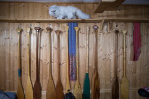

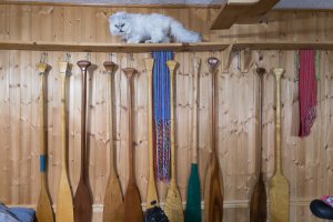

Here is an indoors example with the Sigma 20 F1.4, shot at F1.4
AF is set to spot and using the centre point, and centered on the coloured sash in the middle of the frame.
I chose this wall as the vertical lines make it easier to notice distortion. The walkway on the top is not straight, so the wobble on it is not distortion.
The first shot is the image straight out of the lens and resized for the forum. The second image is with the Sigma 20mm lens profile selected in lightroom. No other editing was done. Note the change in the amount of vignetting between the two images.
The cat is in the picture because the internet can always use more cat pictures......

Thanks for the photos, Don, they're much more the kind of thing I need to see. It certainly doesn't look like the Sigma's distortion is too destructive to correct and the vignetting looks manageable.
Seems like the Sigma is the smart choice. Maybe I'll have to satisfy my Zeiss lust with a 50mm or 100mm upgrade instead, once I've picked those winning lottery numbers.
