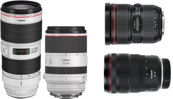

What they omitted compared to EF lenses are the units (mm) and all that 'useless info'. The aperture is where it always was, in small text as part of the full lens designation. For example, compare the 70-200/2.8 (EF III vs. RF) or 24-70/2.8 (EF II vs RF):
For the 70-200, the aperture is on the end of the barrel, for the 24-70 it's printed around the front element. Seriously, is it that hard to tell an f/2.8 from an f/4 zoom just by the size of the lens?
