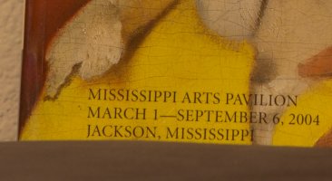

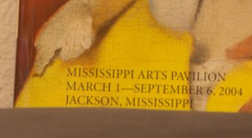

Ok, so here it is. I haven't gotten around shooting at a brick wall yet. But I think I will throw in more tests. This is what I did
1) mounted on a tripod, 70mm, set to AV priority, @5.6, ISO 100, AWB. Center focus point selected. Shot in a living room at night.
2) shot normally (2 sec timer, mirror lockup enabled) @ 5.6 aperture
3) live view (2 sec timer, AF Live) @ 5.6 aperture
If I did this right, then OMG. The shots from AF Live, is way sharper then normal Phase detect AF. I am including the full shot and a 100% crop of the top part of the book.

In that case, get it calibrated, or, if you cannot get it done free, consider selling the 60D and get a 7D and do it yourself. You will then be able to use the AFMA for all your lenses. You might be pleased at the difference.
While I agree that you most likely need things adjusted by Canon, using AV mode may not yield the exact same shutter speeds. Tripod, mirror lock up and 2 second timer definitely helps, but shooting in manual with your aperture and shutter speed locked in should guarantee you are looking at the exact same exposure.
