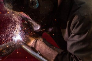

Is that one of the photos from the lensrental article on equipment damaged by the solar eclipse? I'm guessing that lens was trained on the sun for quite a while in live view, and/or had a ton of successive photos taken in a burst. For the amount of time the lens actually stops down to take a photo, I can't believe any amount of light short of a nuclear explosion would be that damaging to aperture blades.
Anyway, I took a few shots earlier this evening. I just used my Rebel T3i and my cheap-o 75-300 lens in case anything did get damaged. The darker areas of the photo have a little noise, and I'm sure a 5D or EOS R would do much better, but the Rebel still does pretty well at ISO 100. Well enough to not want to put a $2000 camera on the line.

Good Job. Yes, that image is from Rogers article. And, Yes, it was likely from a long exposure to the sun, a short exposure it unlikely to hurt, but you really can't tell if the lubricant was melted and broke down.
