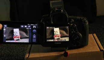

This is live view with a 5D4 tethered to a smart phone
With Canon utilities, there is a option to turn the lcd on or off, I'm not certain if its there on the iphone. It was turned on by default, but I quickly turned it off.
I have not yet arrived at the point of tethering my 5D MK IV to my iphone, but my 5D MK III did not turn on the lcd.

I hooked up to my iphone tonight:
You can turn off the live view display while tethered to my Iphone using a 5D MK IV and Camera connect. Just open the options settings and select "Live View Display" while in live view. This turns off the rear lcd and the display on my iphone. Then close the options panel and trigger the shutter.
The function is related to the camera connect app, and is likely to be the same for all DSLR's with Wi-Fi.
However, live view is not intended for long exposures. It will shut down after 30 minutes, if your battery does not run down first, its even less desirable to use a smartphone remote.
As mentioned above, use live view to autofocus, and then trigger the shutter with live view turned off.
