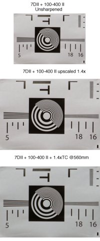

My experience is that there is no significant advantage of using the 1.4xTC with the 100-400 II on the 7DII (but it does better on the 5DIII). The loss of IQ from the TC combined with an extra stop of noise gives it hardly any advantage over the bare lens plus a slight loss of AF and restriction to one focus square at f/8. Here are some shots of the centre of an iso12233 chart done with the bare lens on the 7DII compared with the 1.4xTC added and also the bare lens upscaled 1.4x using Photoshop. When colour is involved, as with bird plumage etc, the TC will fare worse because of any CA added.
ps - you can see the loss of IQ on adding the TC on the TDP site
http://www.the-digital-picture.com/Reviews/ISO-12233-Sample-Crops.aspx?Lens=972&Camera=963&Sample=0&FLI=5&API=2&LensComp=972&CameraComp=963&SampleComp=0&FLIComp=4&APIComp=0
The 7DII works brilliantly with very sharp lenses but the smaller pixels are more sensitive to softening of the lens whereas the FF is more resilient.
Alan, you need to shoot your targets from far enough away that the resolution limit is somewhere in the range of your target. In both of these shots, the resolution limit is beyond the high-end of your target so nothing can be determined.

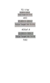

I was 25 metres away, with a good size target. You can look at the sharpness of the numbers and the curves in the same way as you do for images on TDP. The 1.4xTC is ever so slightly better. Here is the small print on a Focal Target at the same distance - the 1.4xTC is slightly better, but the gain is hardly worth the hassle of holding a longer lens steady at a narrower aperture. (Top = 400mm, middle = 400mm upscaled 1.4x in PS, bottom = 400 + 1.4xTC). I have tried the lens with and without the TC on birds and get a much better keeper rate without the TC. On the 5DIII, the 1.4xTC is great.
That isn't slightly better, that's dramatically better.
Shoot a target like this one and see which lines of text are readable.
Lee
I have the camera(s), I have the lens, I have the extender, and I have no axe to grind. To me, it is not worth using the 1.4xTC on the 100-400mm II and the 7DII. If I was taking a picture of the monochrome moon using a tripod, I would use the extender. But, for general bird photography, no. Though I do use it with the 5DIII.
