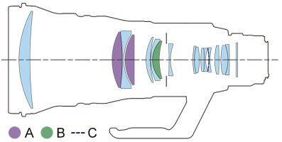

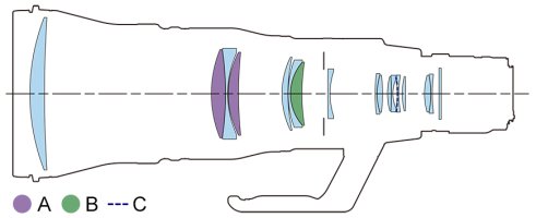

I had to go digging for it because Canon USA didn’t publish them, but eventually I found the lens designs on the Canon Japan website. They confirm that the 800mm is the same as the RF400mm with a few extra elements at the back. The 1200mm is just the Rf600mm with those same “doubler” elements at the back.
Now that we know the prices, this means Canon is essentially charging $5000 for a built in 2x extender. Yes; I’m sure it’ll be better than using an extender, but… $5000 better? The prices seem steep.
Whats more, the MtF charts are not anything special. If you compare the 800mm MtF chart with the MtF of the RF600mm+1.4x TC (840mm) they are very similar. They also show quite clearly that the bare 1200mm and 800mm lenses are not as sharp as the 400mm and 600mm.
Big white lenses usually get me excited, but I’m not sure how I feel about this. These were already EF lenses with an flange adapter tacked on the back.
I do think the 800mm will be popular with the wildlife folks, but man do you ever have to be sure you want 800mm ALL the time to spend an extra $5k to not add an extender! I’ll be very curious to see someone do the tests.

Here is everything I dug up on Canon Japan including the MTFs of these lenses and the EF Mark III/2xTCIII (no MTFs exist for the RF 2x and the RF 400/600).
1200:
600:
800:
400:
RF 2xTC:
1200:
600III/2xTCIII
800:
400III/2xTCIII:
I don't know about you but these look really similar with just a slight edge for these new optics over using a 2xTC on the Mark III lenses. Probably using an RF TC on RF400/600 would be identical to these new lenses because people claim the RF TCs are a step above the EFIIIs.
These lenses are just built in 2xTCs.
I see these being used by governments, survelience or maybe wildlife videographers that would add additional TCs to these for the super long reach. But for stills photography I'd save the $$$ and buy a 400 or 600 and use the 2xTC to get these focal lengths given the price and the MTFs.
The only difference I see is that one extra UD element just ahead of the "TC" element.
