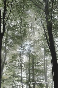

Landscape / IMG_6090 @ f/5.6
IMG_6090_ef-m_32_14_stm_C-bockhorst.JPGIMG_6090_center-strip.JPGIMG_6090_lower-strip.JPG

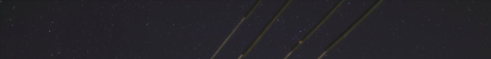

Stars / IMG_6194 @ f/1.4

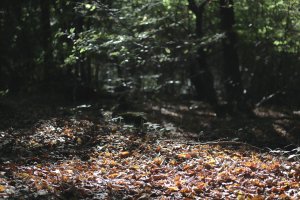

Forest scene / IMG_6249 @ f/1.4

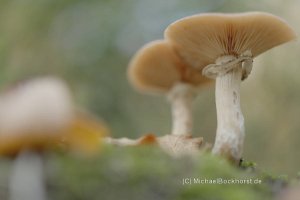

About the Digital lens optimizer: If you have normal textures it doesn't make a large difference. In the case of the fibrous outer shell of the mushrooms stem it makes a big difference: from "it has fibrous texture" to "there are a lot of fine fibres".
@f/1.4 / DPP: sharpness 3 / Digital lens optimizer
Full image scaled down:
100%-crop detail right mushroom2018-10-21-10-37-53_M50_IMG_6469_right-mushroom.JPG
