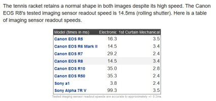

I researched and the result I found excited me. The Canon R8's rolling shutter speed looks the same as the Canon R6 Mark 2. (14.5)

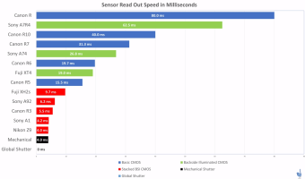

I don't know where he gets his measurements from. Here is another set posted elsewhere on CR, which has some different values, and I don't where they come fromreadout speed.png.
I don't know where he gets his measurements from. Here is another set posted elsewhere on CR, which has some different values, and I don't where they come fromView attachment 208572.
There is a table I added on the web page I specified. I have no way of knowing how they did the test. I also know about the table you sent. Maybe they can add the new Canon R6 Mark 2 and R8 in the coming days.

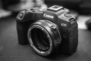

I use my R8 with a drop in ef to RF adapter with a clear filter. I don't use RF glass, so my rig is all EF optics...the filter acts as a permanent sensor / dust sheild. It's permanently on my R8 and so far I've not had any dust issues at all. In fact I've had less than I would have seen on my DSLR's.
