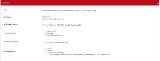

Can EOS-R / RP camera users confirm this?
I have no idea why an AF assist beam would not work. However, I have shot in near blackness with off camera flash and had no problem either seeing my subject (through the EVF) or with AF. This is at f/1.2. No problem at all. I think I shot about 95 photos that night. Never missed focus. Never had a problem. BTW: The camera has it's own LED AF Assist beam. In my opinion, this is a non issue.

Just thinking aloud, would IR LED work for focus assist on mirrorless or is IR blocked/filtered at sensor level?
The R and RP have an LED AF Assist beam. I have no idea how it works, I just know it works. Like Mr. Clark said, it is near infrared and visible, but not infrared.

here is what i just read "The issue, as I understand it, is that traditional AF assist beams are IR which is filtered by the sensor's IR layer. In a DSLR, the PDAF system can see the AF assist beam and focus is acquired without the sensor readout. With mirrorless, the sensor is performing AF, so those traditional AF beams simply cannot be used as they are being filtered. "
Might just be the answer. I read the same thing in another forum. I just have no idea whether he's credible or not.
I still wonder why there is: 1. Enable, 2. Disable, 3. LED only. It just seems strange to me. Then again, Canon didn't go to an LED on the camera side for nothing. Maybe less expensive?
