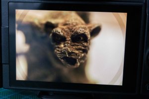

I just bought a Laowa 100mm macro lens, and I've used it with the EF-RF adaptor. Two problems:
1. It forces a 1.6 cropping ratio (no others available) &
2. Through the EVF (and the back screen) I get a circular watermark on screen as below:
This watermark stays in the saved image. But when I download the image into Lightroom, while the watermark initially appears on screen, when it prepares 'standard previews', the watermark disappears - and doesn't seem to be in the actual image! My suspicion is that it is showing the 1.6 crop on screen. But it doesn't do that when I attach an EF-S lens.
Any ideas about either of the above issues? I've tried the lens on my 6D and it doesn't seem to be cropping, and the watermark isn't there. The EOS R is certainly recognising the lens, because it can control aperture, and the 'lens aperture correction' recognises the specific lens. I've tried turning off the corrections, and that doesn't make any difference.
Is the "Lens Aberration Correction" set to ON? If so, turning it off may remove those circles. I remember some old Sigma lenses showed something similar when the aberration correction was on.
All the Lens Aberration Correction options (Peripheral / Distortion / Lens Optimiser) are all set to 'ON'. I tried them on off as well - but no difference. Sorry - I said 'aperture' correction above - I meant 'aberration'.
Hang on - I've just tried turning off the Lens Aberration Correction options again, and the watermark disappears!
It is still showing a 1.6 crop though - but I'm wondering whether this is real or not. I'll try and test with my 6D.
Edit: it is definitely cropping - the image is much larger than on my 6D.
It looks like it gets detected as an EF-S lens, Laowa will have to fix that with a firmware update. Have you contacted Laowa about this issue yet?
I think you're right, although it's odd that it can be the case when the camera can recognise the specific lens for correction purposes. The Australian supplier was going back to them late Friday - I'll pass on the reply when it comes.
They are bringing out an RF mount version in March, but the EF mount was on deep discount in Australia last week so I jumped. Looks like its going back. Works great on the 6D by the way ...
