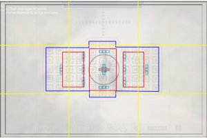

Why do you show an example of the Nikon D750. Your claim was that the 6DII had the same spread as the 5DIII, and that is wrong.
And how is it noticable? I have the 1DXII and the 5Ds. The spread of AF points is only slightly bigger on the 1DXII, but I really do notice a difference.
Edit: after comparing the spread of AF points, my estimate is that the AF point 5DIII spread is 30% wider than the 6DII.
red- 6D II
blue - 5D IV
if you, guys, still believe that the AF spread is almost identical, then never mind... next one! :)

no, this is 6d II. that is not 11 AF points of 6D original.
attached 6D II overlay over 6D original. in the previous post I contoured 6D II AF points in red and 5D IV in blue.

You do realize that you are comparing the 5D4 against the 6D? Note the 11 AF points in your diagram.....
