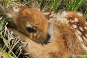

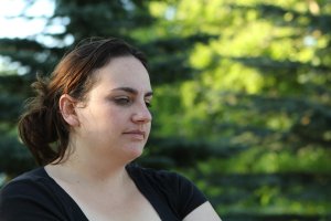

Hello, I'm just a hobby photographer, a long ways from knowing everything I need to know. I recently bought a used 24-70 from KEH with an Ex+ rating. I was a little nervous about getting this lens because of what I've read about bad copies. I'm still trying to figure out if I got a good one or not. Some photos seem sharp some don't. So, I don't know if it's me or the lens...or both. Can I please get some insight with this? I'll try to post a few different pics I recently took with this lens....

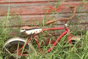

pic 4...This is the one worries me the most. I've had a couple turn out like this. Kind of seems out of focus. All of these ones are hand held. I did adjust saturation a bit on the 1st one, pics 2, 3, and 4 are untouched.
I've had five of the older 24-70mm L model, and while they were all right, just not spectacular. The images you posted are a bit difficult, because we do not know where the AF point was, or the camera body settings.
I find FoCal is a good way to give a lens a good bit of testing for not only autofocus accuract, but consistency of autofocus. You can also find out at which settings your lens is the sharpest.
The 24-70 does have way too much field of curvature, which on closeups with a wide aperture will mean out of focus edges, or if you focus toward the edge, the center will be soft.
For those with a crop body, you can get the 17-55mmL, but with FF, I'd get a new one locally, as it can take a few tries to get a really good one. The field of curvature will not improve though, its in the design.
I am using a crop sensor t2i. I'm pretty sure I just used auto-focus, aimed at the crossbar on the bike. I just checked the settings and it was: 55mm, F7, 1/80th sec
Could that 1/80th handheld be the culprit in this photo?
Also, I went with the 24-70 over the 17-55 because I read alot about dust issues with that lens, and though I'm as careful as I can be, I'm a little clumsy, AND I change my lenses alot out on dirt roads and in the woods looking for wildlife. I hope to some day have a Mark ii as a 2nd camera to carry around so I figured when that day comes my 24-70 can go on that one.
Yes, it's user error. All the photos are tack, save for the last one, shot at a slower shutter speed and at 55mm. You were probably just moving around too much as you shot it.
Know that as a base rule, whatever shutter speed you're shooting at should be a 1/x of whatever lens length you're at. This helps to combat camera shake.
Example: If you're shooting with a 50mm lens, you'll need AT LEAST a shutter speed of 1/50th to get a sharp image with average camera shake.

Yes, the old 1/effective focal length (1/1.6 X FL) was ok for 5mp sensors, but for 18mp sensors, double the minimum speed, for 50mm on a crop camera, try to use 1/160 or 1/200 sec to reduce motion blur. To test a body, use a tripod, or a really high shutter speed, 1/640 or 1/1000 to pretty much eliminate motion as a factor. you will be much happier when you get the shutter speed up.
The 24-70mm L is very unbalanced on a crop body, so it gets more handheld movement than a better balanced lens.
I'd give it some more time before getting worried. It appears that your lens is at least capable of taking sharp pictures. For example the shot of the dear is sharp, as well the 'ear' of the woman you took a picture of is very sharp. Are you using a focus region or a selected focus point? The other shots could do with being a little sharper, the first image of the fence and flowers as well as the image of the bike should be sharper on that lens. I have a copy of the 24-70, it's razor sharp throughout on both full frame and crop.
Higher shutter speeds, practicing steady hands, taking multiple pictures of the same image, practice focusing. The advice above about using a tri-pod with a delayed 2 second shutter and shooting with various settings in live view is worth trying. I don't see anything that jumps out as a problem with your lens, so do a bunch of tests, get good at it before you start worrying. Also, just a basic note for you, if you are shooting wide open at 2.8 on a scene with objects at varying distances, only the objects in line with what you focused on (focal plane) are going to be in sharp focus, everything else will gradually recede out of focus, so you may want to pay attention to testing at higher f/numbers as well as faster shutter speeds. Also, I would compliment your composition, the framing choices in all of your shots is quite good.

The bike shot just got movement blur cuz shutter speed was 2 low

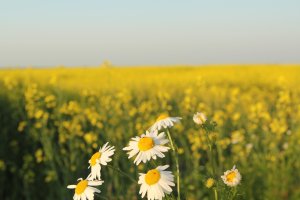

Hello, I'm still a bit concerned about the lens...or maybe an issue I'm having. Here are 3 photos I took the last 2 nights (basically the same lighting). The first pic (of the deer) was taken with my 100-400. This photo is unaltered, but in another version I was able to brighten it and adjust hue so it looks pretty lifelike. The 2nd pic (flower) is also unaltered, taken with my 24-70 on a tripod (F7, +1 Exp, 34mm). I was able to look this one look decent with some hue alteration and brightening in another version of it. Now pic 3 was taken with my 24-70 on a tripod, remote shutter at F11, +1.3 Exp, 1/50 sec. This doesn't really look anything like real life. It is almost orange whereas the field is actually bright yellow. Pic 4 was also taken from a tripod with remote shutter. This time at F18, no Exp. Comp, 1/10 sec at 35mm. I don't know what I'm doing wrong. I'm new with this lens but it shouldnt be this hard! One other thing I should note, the pics with the 24-70 were taken with a B&W Polarizer. I'm pretty sure I tried it without the filter and got the same results. I'm stressing out here. My new lens should be fun!
