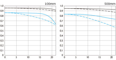

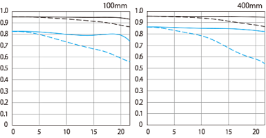

Let's face it, an MTF30 of ~0.8 is disappointing for an f/5.6 supertelephoto - it's what you get after image degradation from a 2xTC. The old EF 800/5.6 had 18 elements in 14 groups, the new RF 26 in 18 groups - more means worse here. It looks like what we call here a bodge. Here are the diffraction corrected latest MTF charts for the new RF800, old EF800 , RF600, and EF600. For comparison, at the end is the RF 100-500mm at 100 and 500mm, a zoom at narrower aperture. Maybe it's very difficult to make an 800mm short enough physically.
View attachment 202614View attachment 202615
View attachment 202618View attachment 202619View attachment 202620
If I didn't have the EF 100-400, one of my two favourite lenses, and if I wasn't broke, I would certainly order the RF 100-500.
A fully convincing lens, and even more thanks to your spending many hours testing it!
Reactions: 4 users
The EF 100-400mm II has very impressive MTF values. It's a classy lens. The values at 400mm f/5.6 are slightly than the 100-500mm at 500 f/7.1 because of the slightly less loss by diffraction. The 100-500mm at 100mm are pretty close to a prime lens, which was confirmed in the tests by opticallimits.com.
