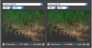

I hate to be "that guy" (I'm lying...) but I actually see slightly less chroma noise, and less damage to detail from luma noise, in the R5 image, viewed big.
Which doesn't surprise me in the slightest...
I’m sure they are within processing distance of each other, and the differences so small they would be practically impossible to see at normal output sizes.
I think we can all agree (I’m sure we won’t) that the high iso performance difference is not big enough to base a purchasing decision on.
Regarding the other long running question, I see less than a stop difference between the R5 and the R, probably 1/2 to 2/3, so anybody hoping to see big gains there will be disappointed.

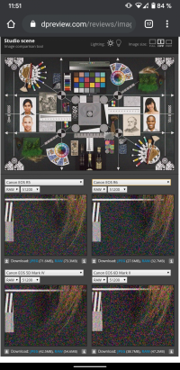

I’m not sure it is down that low. Here it is at 1,600.
Thanks for the link! They are very close at 1600. I would still give the R5 a slight edge though... glad it hasn't lost any ground to the older sensor

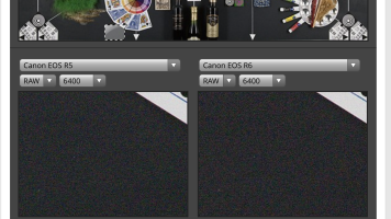

and the reason is (likely): left and right files are identical, the same file being compared..due to a human error :) I found a spot in the image that is purely noise pattern and it is identical in both samples... I am not going to bid my house on it. but... it is a miracle otherwise.. not what TDP samples are showing. there is a difference and noticeable in the level of details available at ISO6400 specifically. R6 is slightly more detailed.

In the shadows, the color noise does not compare, one to one, to my eye.

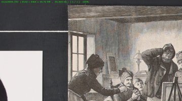

Edit: To expand upon my skepticism, if the files were identical, how does this difference in aliasing came about:
From: https://www.dpreview.com/reviews/im...=1&x=0.5782423487760326&y=0.07903900901043959

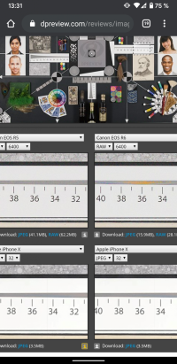

but back to your request. Here is a screen shot. (R5 and R6)

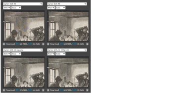

there is quite a bit of a colour banding or aliasing in the top left corner (R5), much less of the same for R6, I can detect a slight bit in 5D4 and none in 1Dx3.
Does not look right to me. I have seen this in 5D4 from time to time. but not as pronounced.
p.s. there is that blotch of colour (yellowish, somewhat) on the person's face in the bottom left corner (R5). there is no such an issue in neither R6, 1Dx3 or 5D4 test image. that's crap..
