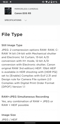

I have read that using ES decreases both bit depth and DR.
That is correct. Although decreasing the bit depth for linear data is the same as reducing the DR. Note that this does not matter for images taken with ISO 800 or higher. For the exact amount of DR lost when using fully electronic shutter or the high FPS mode, see:
Is this true for both EFCS and full ES, or just full ES?
Just full ES. EFCS is 14-bit. It drops to 13 regardless of shutter mode for high FPS shooting and drops to 12 for full electronic shutter. See:
Note also that EFCS causes artifacts in out of focus highlights when using very fast shutter speeds. See photos In this thread for examples.
