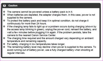

The manual covers powering the camera from USB. Apparently, its only for a limited time, it says use a fully charged battery. See the last bullet below.
