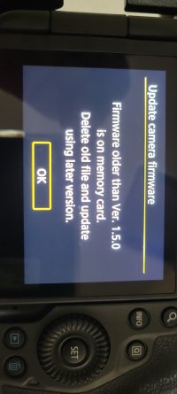

I uploaded the firmware update to move from v1.5.0 to install the v1.5.1 update on my R5 and received the following error pictured below. The byte count appears to wrong as the upload shows 51,873 KB while Canon website shows EOSR5151.FIR / file size: 53,117,856 bytes.
