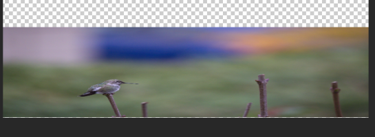

not an expert here, but always like to help where I can. A quick look at On1 Photo Raw and the TRANSFORM tool (not crop), you can drag one side or other and it seems to squeeze or pull the image which is what I imagine you need. I'm sure other editors can do similar. It also can be done in ON1 Lens correction via the transform tool and changing the aspect ratio, but seems a bit more challenging to work with. This is a hummingbird I stretched.. can squish too. 1653243043167.png
