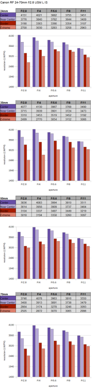

Color me skeptical about prime lenses, when you can pick up a 24-70mm f2.8L zoom for the same price. If you look at the lens resolution charts on Canon's website, it appears that the 24-70 is a much better performing lens. I'm certainly not an expert but below is the 50 mm and the 24-70 at 70mm MTF chart. From what I can see, the zoom blows the prime away. Since switching to primarily zooms, the versatility of a variable focal length lens works for me.
Eh I'm guessing you don't know how these tests work, but they're often low-moderate frequency tests as well as these #s are wide open. It's a bit misleading to compare a super fast prime vs. a zoom.
When it comes to high-frequency resolution such as MTF50, especially periphery at optimum aperture, zooms are absolute garbage compared to primes.
In this case you're looking at 2.8 vs 1.2 at mid frequency. So yeah the zoom will show higher numbers.
But for ultimate detail in an absolute sense, particularly towards the mid/edges/corners, a decent prime will trash a good zoom in fine details. Go read Roger Cicala's blog at lensrentals on this.

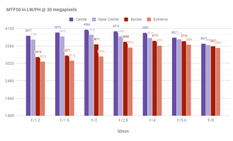

Be careful with that sharpness comparison: the zoom is at f/2.8 and the 50mm is at f/1.2. You should really compare the 50mm stopped down f/2.8 to compare the sharpness
Unfortunately, that's how the charts are published. While I don't know how much sharper 1-1/2 stops would add. My point is simply that with modern optics why tie yourself to a fixed focal length (prime) when a zoom gives you more possibilities for the same price. Heavier I grant you but having the ability to go from a moderately wide-angle to a short tele allows shots that you can't get with a 50mm. I don't miss the 1-1/2 stops as I like to shoot at f8 when possible and let IS and IBIS help with the slower shutter speeds. The link below illustrates using the 24-70 for a full-length shot of a model and then cropping the image down to her eye to show how sharp the lens is.
I wouldn't take the charts too seriously. I had both lenses and the 50 was the better performer in just about every regard, at least for what I shoot.
Oh, we're not arguing about the versatility of zoom lenses! I have 4 zooms and 'only' 2 primes, so you're preaching to the choir.
For sharpness vs aperture, look no further than TDP. Bryan publishes test chart results for all aperture values and comments on how the images improves (or not) with aperture. Uncle Rog sometimes measures (and publishes) sharpness across aperture, but only for primes (zooms take too long time), and usually only for a specific educational purpose.
PS: I believe that there are 2.5 stops between f/1.2 and f/2.8, not 1.5 stops
The whole point of the f/1.2 is that it has an f/1.2 aperture, and the widest on the 24-70 is f/2.8. If you need f/1.2 for light and bokeh, get the prime. If f/2.8 is enough for you, get the zoom. Both are damn good lenses. Opticallimits, a great site, one of the very best, has mtfs for both lenses as a function of f-number.

Back to the main subject: I haven't tried either but the Leica APO-Summicron 50/2 ASPH and the 50mm Otus are both apparently in the running for sharpest lens ever.
The Canon 50/1.2 is a steal in comparison. You could buy like 4 or 5 for the price of the Leica. And the Canon goes to f/1.2 so if you had to decide between them that should make it easy.
But the vignetting is EXTREME. You can correct in-camera but it is sooooooo extreme that the camera may simply not have enough exposure to give great results. Things that should be zone II or even III are literally just 0 values or something. No amount of boosting 0 is going to give you a natural-looking image. I love 50mm but I don't use my 50/1.2 much. OTOH I use my Leica M 35/1.4 all the time on my R, because its so compact, and makes good-looking images.
