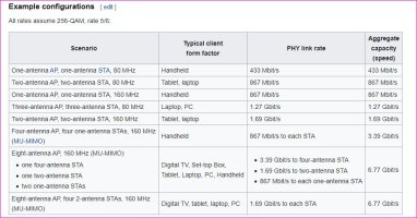

The number of mimo antennas plays a limiting part on the speed. 5GHZ has a shorter range, but that's not a issue for me. I'll find out soon, mine shipped today. My AP is theoretically 867 Mbps but practically, its gong to be a lot slower. I don't have anything that fast connected to it, most of my equipment is hard wired, a lot is limited to 2.4 GHZ.
I expect the camera has a 433 Mbps radio and will also be a lot slower. Still, I think I'll compare the two cameras as best as I can. Test reports of the Orbi show a 552.11 Mbps real world speed at 5 ft. I'll usually be at 12 ft but no further than 15 ft which is still over 500 Mbps.
I don't know what speed to expect once it goes thru the Canon radios and software but if I get 200 Mbps, I'd be surprised.

I received my CFexpress card today, I thought I'd use it to do the speed tests. I shot off 17 raw plus jpeg images and it took a long time to FTP them to my PC. I had a issue with my Access point today and turned off the display of 5GHZ SSID to test something. I can't get it back on so I had to enter it in the camera manually. Its a pain to get into the setup, I need to fix that as well. The camera displayed a wireless download speed of about 300Mbps.
In any event, downloading with the CFexpress to lightroom is blazingly fast. I downloaded a few bunches of about 15-20 raw and raw+jpeg in a few seconds. I had been using my V60 SD UHSII card which is definitely limited by the card speed. I don't have a super fast thunderbolt 3 connection, I use USB 3. For a huge video file it might be a issue but for stills, its much faster than I've ever seen it.
