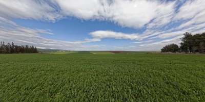

One can get nice results, though. I'm attaching a landscape I defished from an EF 15mm f/2.8. I had to crop a bit right & left, as the results were too bad to keep.
