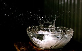

Dear Friends.
I just want to have FUN , many years ago, Try to shoot the splash water with super high speed shutter and Flash syncronizer.
Enjoy, and have a great weekend.
Surapon

Hi Surapon, I noticed you have quite a lot of wall behind the glass bowl visible. You could solve this buy making a snoot for your flash:
This will restrict the area your flash will hit instead of spreading it around. You can also restrict the light spread in vertical or horizontal only, but covering only 2 sides instead of all 4. Set your flash zoom to telephoto in order to not waste your flash output. Note: the head of the snoot can be bigger than the flash head! Set it up so the light hits the areas where you need it, but no further.
For your last image, unless you want the "ghost" appearance the multiple exposure, you could take 3 exposures and combine 1/3 of each shot into one shot. Remember to use a good tripod for the camera and the flash for absolute stability and evenness of light.
Happy shooting! :)
