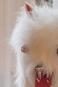

Here are two 100% crops of a photo from the R5 on a tripod. Both are with the EF 85mm f1.2 II. It's a 6 second exposure, ISO100, f16. First one is with the IBIS left on, second is with it turned off. Only thing I did in post is brightened the shadows a little. I see no difference. Edit: You know actually maybe the one with IBIS off is slightly sharper? What do you guys think? Also these are very fine hairs on this doll, and I had a ceiling fan running elsewhere in the room, so maybe they moved just a little bit during the first exposure? I dunno.
I think the whole "turn off IS on a tripod" thing is a really outdated piece of advice that hasn't been relevant since the very early days of IS or IBIS.
That said, I remember that my first gen Tamron 24-70 f2.8 with IS would mess up your shots if you didn't turn off the IS on a tripod, so I usually do anyway just out of habit. But it's probably not needed with almost any modern piece of gear.

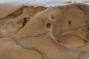

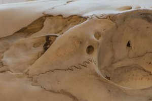

Ok I did another comparison, this time with something that wouldn't have a chance of moving. Both 10 second exposures at f16 this time, first one with IBIS on, second one with IBIS off. I also used the exact same focus for each. In the last one, I autofocused before each one, so that might have thrown off the results.
I really don't see a difference in this one.
