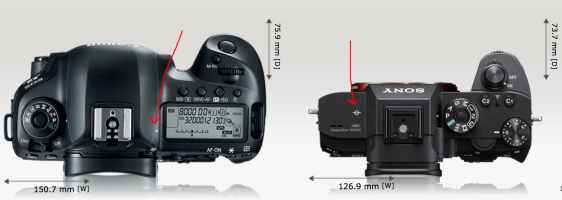

I think these bodies can be an inch thinner, but looking at Sony's a7Riii, their sensor position in the body appears to be a bit further off the back based on the sensor symbol. Canon's body appears to have less used space behind the sensor:
I'm guessing that technically Sony's full frame mirrorless body could be even thinner than it currently is, but as with many things - just because you can doesn't mean you should!
Yeah, I stared at this prior post's pic (forgive me, I'm terribly at linking stuff from other pages in this new quoting system -- think was from page 6 or 7 of this thread) for quite some time to figure this out...
...and then I looked at the focal plane indicator and it made sense. Sony might shave an inch off the mount compared to EF, but they might have a good 1/4-1/2" more stuff behind the FP indicator than a Canon SLR does.
If it has unused empty space in it.

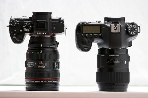

You're both right. It can be thinner because it was thinner:
Look at the added thickness behind the step down from the top plate to the back -- the surface where you see Menu and C3 in the A7R2. All the A7s got thicker over time, presumably due to all those cameras were being asked to do -- 4K + IBIS + higher throughput surely put a higher cooling burden on the camera.
I highly, highly doubt they didn't just leave an air gap in there with that added thickness. It's either added cooling features, additional processing horsepower, or possibly something to do with the addition of IBIS.
