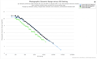

The better Canon sensors are isoinvariant above about iso160-200, which covers much of their range: see
http://www.photonstophotos.net/Char... X Mark II,Canon EOS 5D Mark IV,Canon EOS 80D
for 5DIV (=EOS R), 80D, 1dXII
