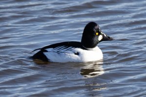

Here is an example of my disappointment with the RF100-500. About 50% crop, animal Eye AF was locked on, ISO 1000, 500mm, f8, 1/2000 sec.

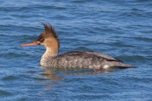

By comparison I am attaching an image from my RF800. 75% crop (I mean the image is about 25% of original), ISO 1000, f11 obvs, 1/2000 sec.
I can tell based on looking at the water that the bird is dead center in the plane of focus, so it does seem like something might be off with the lens elements. It's definitely unacceptably soft, even for a heavy crop.
Was it shot with or without IBIS? Wonder if that is introducing blur somehow.
Thanks for the comments. I leave IBIS on. My RF800 images are really good. I am quite depressed about the hundreds of images that I shot with the 100-500. I am tempted to buy the RF600 now. I am usually at 500 for birding shots.
