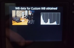

Ok I will back track my statement in one fashion. The only issue that I've noticed is in the custom white balance where you take a shot to custom white balance the camera to the scene. It seems to be very cool when it selects the final white balance. It seems like the picture that is taken looks good and properly white balanced but when it goes back to live-view (and in the case of the R6; in the EVF and the back screen), its very cool and it doesn't seem like the right white balance was set.
It could be user error, but it seems pretty straight forward, except that when the picture is taken there is nothing on the screen that you would confirm the white balance it aquired, other than the picture and the histogram. There is no "press set to confirm WB" or something like that.
It could be user error, but it seems pretty straight forward, except that when the picture is take there is nothing on the screen that aquires the custom white balance other than the picture and the histogram. There is no "press set to confirm WB" or something like that.
Do you get this screen and then “wb registered” or something? Seems alright looking at my histogram.
I most certainly do not get that screen, especially on the right hand side...mine is blank..in the lower half. Again, maybe I'm doing it wrong?
The right screen is set up with cycle on info an scroll down, to show rgb histogram.
the first one you need to be already in custom WB, and then you have the option to use the trash can to set wb. If that doesn’t show you perhaps have selected another wb than custom.

Interesting indeed. Here is the process I follwed.:
1. Live view
2. "Q" button on upper right of screen.
3. White balance (3rd button down on the screen on the right)
4. Select custom white balance icon on the bottom row of the screen.
5. Select "Shoot to set WB"
6. Take a picture.
And then the screen in the attached file. I've pressed the info button, the trash button, I've attempted to move the AF selecter up and down. Nothing seems to happen at the end of that sequence and when the camera returns to live view, its certainly not the correct white balance. Its a very cool WB, nothing like the picture take to attempt to aquire WB.
Hopefully I'm making sense here.
When it says “shoot to set WB” you need to press the trash can FIRST (y) then the first screen posted earlier with the double square in center will show up.

I've pressed the trash can and I've tapped the button. Both bring me to the screen with the square to take a WB reading, but then nothing. (it would appear).
What kind of grey card are you using? And if you’re under flickering lights and do not use anti flickering it will affect the wb sample.
