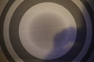

Just got my R6 today, An this dark ring popped up?
I don't see your picture.
But dark rings with Sigma lenses are know to come from one of the setting. Can't remember top of my head, some vignette correction, auto-light-correction or such.
Just turn it off and you'll be fine. It's useless setting anyway.
Wow Im a idiot. lol Thanks

Slapped my Sigma 35mm 1.4 Art on the body. An this ring showed up on the screen in images. Not with my Canon glass tho. I dont have the dock to update the Sigma lens. I just ordered one, I hope that is the issue.View attachment 192508
I'm trying to figure out how you superimposed an over-the-pole picture of Saturn onto acoustic tiles.

It also saves a few clicks in DPP4 if you want them with RAWs. And with Digic 8 and newer, a subset of corrections also gets applied to video.
Thanks for pointing it out. But said subset of corrections does not introduce the ring artifact in videos, does it? At least I haven't seen it.
While we're clarifying things, should the Art line lenses with the newest firmware not add the correction profiles for proper support? I remember an announcement quite a while back saying that they had managed to get correction data working with a firmware upgrade. Guess I misunderstood something there or the OP doesn't have a current firmware on his lens?
Anyway, I wasn't saying that this is not a inconvenience. I just don't take to well to people jumping on to a question thread with a statement that essentially means "Look at me, I am able to always pay significantly more for my products (twice as much in this case) to avoid minor inconveniences". In my eyes, it's just a silly thing to say, as it is the equivalent of answering "You should have bought something better" when somebody asks for help with a problem.
I had to look it up, the RP manual says: Peripheral illumination, distortion, and chromatic aberration can be corrected as you record movies. So the onion rings should show up in movie mode as well.
From what I have understood, select Sigma lenses have a firmware update available that adds the data for those corrections. My copy of the Sigma EF-M 56mm f/1.2 had it out of the box. My 150mm macro doesn't get firmware updates and the 105mm I rented didn't have one either at that point in time.
I agree with with the general idea of your statement, but for lenses specifically, I will prefer Canon lenses since DLO is like magic. But for 35mm I'd be getting the RF f/1.8, not the EF f/1.4 :) Same for the 85mm, I preordered the RF f/2 to replace my EF85mm f/1.8. DLO works wonders on the EF85mm f/1.8. But as you say, the price difference is 2x in this case, which would sway me towards Sigma.
My Sigma 150mm is sharper than my 100mm L and takes the Sigma 1.4x very well. But the IS on it is awful, I hope I can disable it on the lens and still have IBIS :)
Disabling "Perperal illum corr" (under "Lens aberration correction") eliminated the dark-rings in my Art 35 until I get around to updating the firmware... Question though, and it may well also be related to our "old" Art 35's needing a firmware upgrade, have you noticed that the exposure is off on the Sigma Art 35 when it's used on the R5? Mine is always about a stop too dark (as is evident in the histogram) even though the R5's meter is reading right in the middle! I own (& have tested) all my Sigma Art glass (the 50, 35, 24, 20, & 14) and it is only the Sigma Art 35 that is always about a stop (or more) under-exposed!
Interesting. Are you using Canon DPP or Adobe to view the image?
I use Lightroom, but the Art 35's under-exposure is easily evident in the R5's display & EVF; even easily seen on the camera's histogram! I got this Art 35 very soon after they were first released, so I'm quite sure that it contains the initial firmware version; and I'm hopeful that a FW update will set everything right... I've got a Sigma Dock floating around here somewhere, I'll try to update the firmware in the next day or to, then see what happens...
