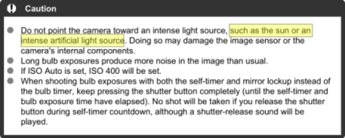

Can does provide warning about sunlight:
But the PetaPixel article about Lidar which caused sensor damage stated "These lasers are designed to be safe to human eyes,...".
I think the average photographer wouldn't automatically equate "safe to human eyes" with "intense artificial light source".
So contrary to what was claimed about this being known for years, Canon might want to explicitly add the words "artificial light sources such as lasers". I don't see a downside to making the statement. Their warning about lasers in some User Manual are to avoid "looking" at lasers through an OVF, for personal safety, not camera safety.
