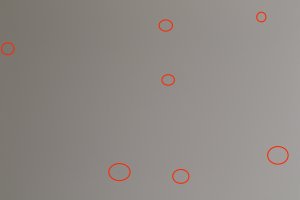

So I have a 7x magnifier but all i could really see was a little dust on the mirror. I blew some air in with an air bulb. Before and after pretty - pretty much no change. Currently see the obvious on this attachment.
update - sorry for lack of info. I saw some dust on mirror and used air bulb to blow off. I had taken a picture, the one I attached right above before hand ( white blank paper). I then put camera in manual clean mode and blew some more air. Released mirror and took another test shot and it appeared the same as the 1st shot - no change. So I assumed the "dirt" is on the sensor. Yes / No ?? Also, the magnifier I have is 7x. Is that enough to see dirt on sensor? Just following The Dust Patrol - on YouTube after looking at the link from above.
Are we even certain there is dirt/dust on the sensor?
Shooting against a bright, even background like a clear or grey sky with a narrow aperture is one way to make spots from dust on the sensor more apparent.
Also don't mess with dust on the mirror. It should not impact any property of the camera and if you touch the mirror with anything, odds of damaging the silver coating are pretty high I think.

IMHO, a blower can be helpful but I suspect you need to clean the sensor. You have two options: Take it to a reputable shop and have them do it; or, do it yourself. I know that sounds a bit scary but it really is not that difficult, with the right tools. Look at a few videos and get some appropriate swabs, a magnifier and the right fluid. Either way, I think that a sensor clean would help this issue.
