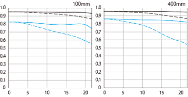

IMPORTANT EDIT: Canon has out-of-date MTF charts listed on its USA site for some lenses. Thanks to alerts from subsequent posts, I have gone to the Japanese site https://cweb.canon.jp/eos/ and have revised the charts and conclusions. This opening post has been rewritten so as not to mislead and I have added data from the EF and RF extenders.
Canon has at last uploaded the calculated MTF values for the new R telephotos, and I have made a collage of them with the those from the 100-400mm II as reference. To summarise, the 100-500 is slightly better at 100mm and slightly weaker at 500mm than the 100-400mm II at 400mm. The differences are slightly magnified by the EF and and RF 1.4x and 2xTCs. The new RF 2xTC gives a significant hit on IQ and does not appear to be an improvement on the old 2xTCIII. The 600mm and 800mm f/11 lenses are somewhat disappointing in terms of resolution and are outperformed in IQ by the RF zoom with extenders where the focal lengths overlap and to a similar extent by the old 100-400mm II.

Of course they haven’t changed the scales. The MTFs are on an absolute scale of 0 to 1. And, Canon doesn’t take into account diffraction, which will lower the f/7.1 500mm more than the f/5.6 400mm. The f/11 will be significantly lower still after diffraction is taken into account.

You're using the OLD MTF for the 100-400 II. Canon updated their MTF charts sometime in the last couple of years and this is the MTF for the 100-400 II using the current process...
I used the latest MTFs on the Canon USA site downloaded this evening.

In 2018, Canon redid all of their MTF charts to new standards. They then did not update Canon USA for whatever reason.
Here is the updated MTF chart on Canon's Japanese website for the 100-400.
And here is the actual image
Here is the 100-500 from the same site
Here is the RF 600 f/11
Here is the RF 800 f/11
I would place the blame for this misinterpretation of MTF charts on Canon's shoulders for not updating their USA website.

Thanks for that information. Canon is very naughty. The f/11 are low by any standard. But, they are relatively cheap. The Canon values are still higher than the actual measured ones by lensrentals using an optical bench https://www.lensrentals.com/blog/2016/08/the-sort-of-great-400mm-shootout/ it really will be interesting to see what the 500 one really is.
