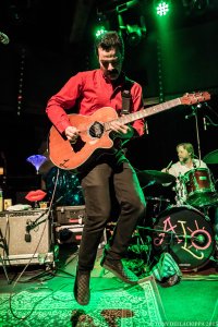

I've shot quite a few concerts. These photos are from my most recent one, just the other week. I went in with my 5D3 and my recently acquired Nikon D3s (which has low light capabilities close to the 1Dx). The colored lights from concerts have always been a bit wonky on my 5D3 (some pinks come out seriously saturated), so I tend to make most of my concert photos B&W. I've also found I can get better shadow recovery from B&W than from color.
D3S_9503 by yorgasor, on Flickr
D3S_0374 by yorgasor, on Flickr
D3S_0486 by yorgasor, on Flickr
For this concert, I was able to keep pretty good proximity to the stage. I ended up mostly using my D3s with old manual focus lenses: 50mm f/1.4 AIS (shooting at f/2, otherwise you get seriously wonky flaring), a 180mm f/2.8 AIS, a 35mm Sigma ART (used at f/2, shot in manual focus, autofocus seemed way off in that lighting) and then an AF-S 85mm f/1.8 (shot at f/2) which I used with autofocus. For this cramped stage, they didn't move around that much, so once I locked in focus, I could squeeze of several shots before I'd check again. I was really happy with the manual focus lenses, as the AF would occasionally track the wrong item and focus wrong. My keeper rate was surprisingly high this way.
I was able to keep most of my lenses around f/2 and my ISO between 2000-3000. My shutter speed was mostly 1/160, which again was fine for a mostly stationary band. If there had been a lot of dancing, it would need to be closer to 1/320 or 1/400, which is pretty tough to do in that lighting.
I wouldn't bother with a monopod unless I was shooting with a heavy lens. The 300mm f/2.8 would surely be attached to a monopod.
The best thing you can do (if you have close proximity and can move around) is to use a variety of prime lenses that work well around f/2. Move around to different vantage points, and cycle through your lenses at each point. That way you end up with a healthy variety of photos for a scene that may not change that much.
With 50mm and smaller, you can get a pretty decent depth of field, even at f/2. For manual focus aids, on my 5D3, I use magic lantern and turn on 5x magnification when the button is pressed halfway for precise autofocus. On the Nikon cameras, they have a focus indicator for MF lenses, where there are arrows which tell you which way to turn to focus, and a green dot to indicate focus achieved. I've also taken a Canon split prism focus screen and sanded it down to fit my D3s, so sometimes I used that to focus.
