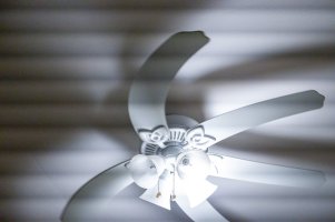

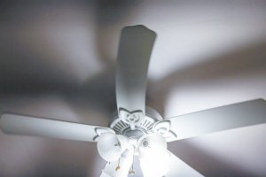

Here's a comparison of the motion and banding issues on the R5 compared to the EOS R when using the electronic shutter. Both of these were taken with the ceiling fan turned on its fastest speed. Disregard the noise in both of these photos. I was running a fast shutter speed in a poorly lit room to keep the motion blur to a minimum. These were both taken at 1/800 sec, f3.5, and ISO 5000 and then cleaned up a little in post.
While the R5 isn't perfect, it's worlds better than the crazy distortion of the EOS R. And keep in mind this fan is turned on high, so it's spinning pretty fast. Even more welcome is the fact that the banding caused by the LED light bulb seems to be pretty much nonexistent with the R5. So worrying about banding from various light sources with the electronic shutter will be much less of a worry now.

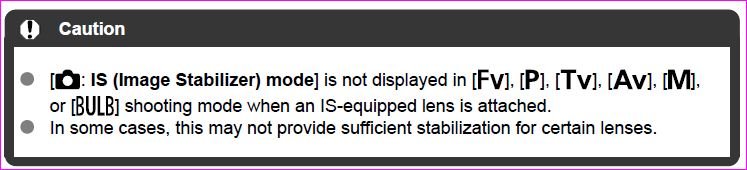

In reading thru the manual, the nots on IBIS confused me. Is it running with a lens which has IS in these modes?

Sounds good so far.
I mounted an EF 70-200 2.8 IS II onto the R5. I tried it in P and M modes. With this lens attached, there is no menu option present for image stabilization. It's not just greyed out, it's totally gone.
In the shooting display, or EVF, when the IS switch on the lens is turned on, there's a little shaky hand icon in the corner. When I switch it off, the shaky hand icon gets the word "OFF" displayed on it. It's pretty much impossible to tell if the IBIS is or isn't functioning when the lens is mounted, but I assume IBIS is working whenever the lens IS is, and IBIS is off when the lens IS is off.
I guess the best test would be to compare what shutter speeds you can get with the R and the R5 (And compare them at the same magnification, not 1:1). But from the Canon marketing, IBIS should be active even with EF lenses and is just coupled to the lens IS switch instead of a menu item.
Wow that’s a major improvement. Thanks for conducting this test so quickly.
I wonder how it is compared to a baseline (using mechanical shutter)?

Much appreciated , looks crazy useable compared to the R...
Yeah I'm pretty thrilled by the lack of banding compared to the EOS R. With the R, the electronic shutter was always barely anything more than a novelty to me because the banding was so bad under so many types of lighting that that you could never trust your shots not to be ruined by it. It seems like the electronic shutter might be a viable way to take normal photos with the R5.
Reactions: Viggo and Ramage

Well there was banding and there was … bending due to electronic shutter :D
