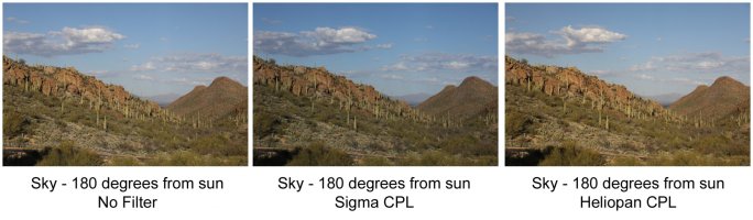

Next I shot directly away from the sun, at a 180 degree angle. As expected, this had virtually no effect, though the Heliopan image may show a slight improvement (and also perhaps a slight warming). The Sigma once again is too dark and too cool (though exposure could be adjusted in camera to make it brighter).

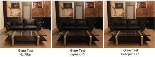

At home I did a final test to see how they compare in reducing reflections of a glass table. Once again the Sigma is noticeably darker and cooler. However in terms of their effectiveness in reducing glare, they are equal. Neither one was able to completely eliminate the glare at this particular angle, though by hand-holding the Heliopan up to my eye at other windows and other angles I was able to see it did eliminate glare in certain circumstances. This is normal in my experience (some glare can be eliminated and some is too harsh and can only be reduced).
