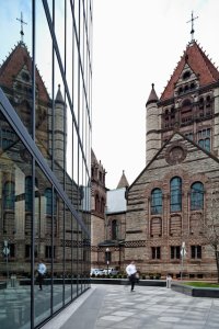

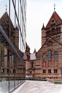

B+W does publish transmission curves (one reason I like them - you know, up front, what you're getting), and it's clear that with the 110 (10-stop) and to a lesser degree with the 106 (6-stop) filter, there's increased transmission in the red area of the spectrum. B+W calls this out in their description of the 106 stating, "Because of its higher transmission in the red beyond 660 nm, this filter brings a slight warm tone to color photographs. If this effect is undesirable, a B+W UV-/IR-Blocking Filter 486 in front of the neutral density filter (not behind it!) remedies that situation." For the 10-stop filter, they indicate that the warm tone is slightly stronger than with the ND 106.
You can see the warmer tone below, top shot is no filter, bottom is the 82mm 10-stop ND from Schneider Optics (parent company of B+W and the only 82mm screw-in 10-stop filter available, AFAIK). As you can see, I use the 10-stop to blur out the people walking through the shot, cars going by, etc.

That's actually pretty dramatic, but since it's very even across the frame I'd assume it can be pretty much completely corrected with a white balance adjustment. Personally, I actually like the colors on the bottom image more, but that's not the point. Did you use manual WB for those? I feel like auto would have picked up on such a large color shift.
Jul 21, 2010
31,169
13,006
Actually, it was Auto WB (which I typically shoot because I always shoot RAW). But the difference in the camera-selected WB is minor - the no-filter shot was 5034 K and 0 tint, and the 10-stop ND shot was 4996 K and +4 tint. Setting them alike doesn't change the differential, although you are correct in that it could be corrected with a WB adustment. But in this case, I completely agree...I prefer the warmer tone anyway!
