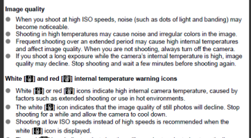

page 284:... no... it says that frequent shooting over extended period of time and shooting in high temperatures may cause image degradation..,
and then it is clearly defined that White or Red internal temperature icons indicate high internal camera temperature, caused by factors such as extended shooting or use in hot environments...
therefore it is absolutely certain that white or Red indicator will be ON when camera gets hot and image quality may be affected in result..
You are incorrect.
You are incorrect.

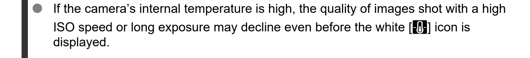

lol i liked how you croped out the part that says it wont always show. are you in denial?
I’m confused... so you could be shooting for ages in still mode and not see overheat warning (which would indicate IQ degradation). But if you switch over to one of the movie modes, The white overheat icon may pop up, indicating that still IQ is (already) in decline?
